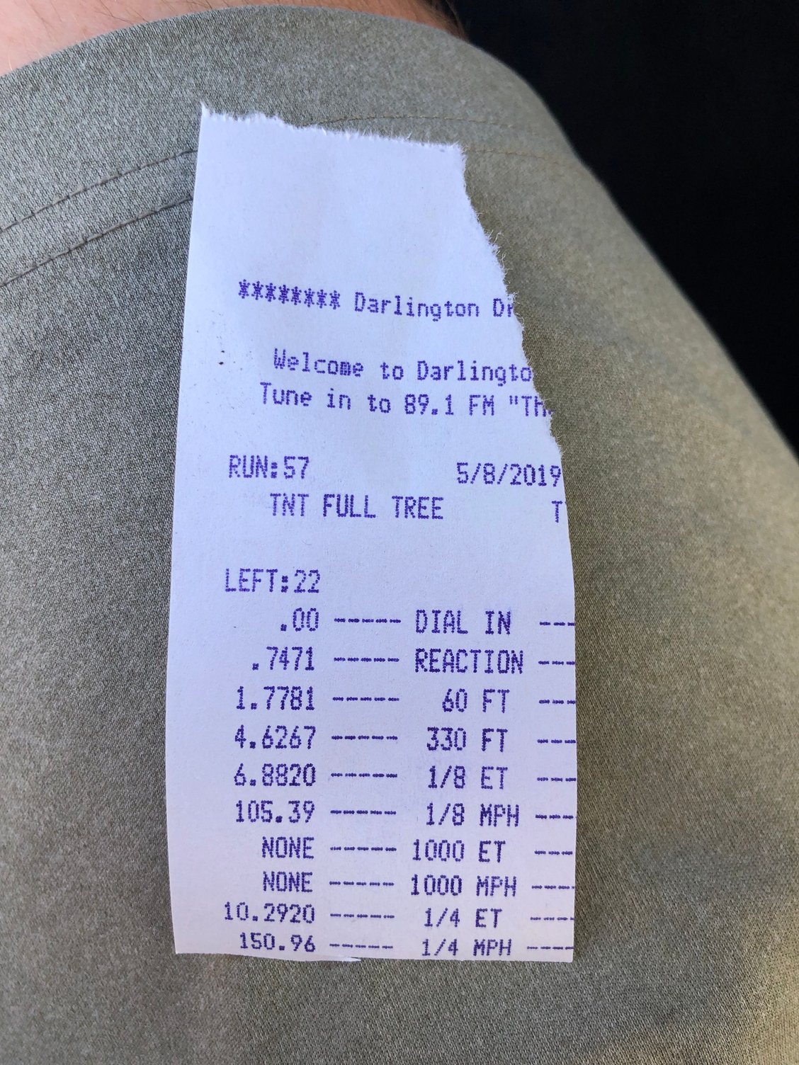

So frustrated with this car right now. Idk why my 1/8 mile time sucks so bad. Also don’t know why my car can’t do a 9.99. The mph says the car should be doing 9.70s. Okay, so my 60’ sucks. So if I do a 1.5 60’ which is pretty much max effort - then okay the car does 9.99 maybe. But it SHOULD be going way faster.
Tuner says 1/8th mile is all suspension / launch but I should be trapping well over 105mph in the 1/8th making 800whp. But I feel like he would know as he has a 9.1 evo 8 himself.
basic rundown of the car
built 2.0
6466
stock ecu
40psi
hoosier qtp
stm d2 drag coilovers
this is is my 3rd outing with the car since having the built motor. Best time is a 10.1 @ 149. Tonight best time was 10.2 @ 150 and then had to call it a night because it started running dangerously lean at wot (think injector is clogged)

If your were to cut a 1.5 from your 1.7x it would be more like a .4-.5 sec difference, every tenth in the 60’ is worth 2 tenths on the back half. Either way your car is fast and you will see a 9 sec pass with some tweaking ! Good luck!

Your 9 second pass is a 60' away like posted above.
1. Do you have a video of that run? I'm going to take a gamble and say you're not revving it out high enough in 1st gear.
2. It's possible you're tripping the light before the car actually squats and launches (it will feel like a 1.4 but only show a 1.7 on the slip for example). Adjusting your clutch switch so the car is off the 2 step as soon as possible helps with this. Release the clutch as fast as you can.
3. Have you looked at the log to see how long you're out of boost between the 1-2 and 2-3 shift?
There's a lot you can do to improve.
