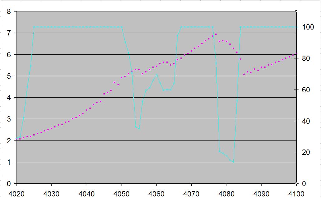

Just to illustrate the point of easing off the throttle in a power oversteer situation to bring the rear back in.... I datalogged this on the way to work. There's this one right hander at an intersection onto a 3 lane street, so there's plenty of room, i.e. margin for error.
Floor the car in 2nd heading into the turn, car is getting near peak torque at the apex, and then yank on the steering to upset the car and get the rear to slide. The front of the car was in the middle lane, the *** end was in half way in the left lane! You can see where the rear started to slide from the rpms getting a little jumpy at 4k rpms. I held it until 5k and eased off the throttle. From there, as the rear was back under control (not sliding farther out), I started working the throttle and then floored it once it was mostly straight.
I must say, the car with a completely stock suspension and tire setup is very difficult to get to oversteer. You basically have to be doing something pretty stupid to get the rear out. It took a pretty good yank on the steering to get the rear to slide for me.
Also, don't try this at home, it was for scientific purposes only

Bravo!
