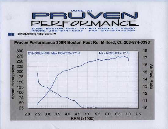

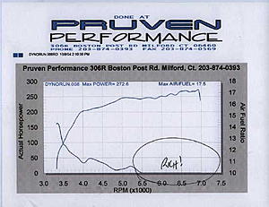

Here is our good friend EvoJimbo who has had the Dyno Flash since almost day one - well over 20,000 miles on his Dyno Flash
EvoJimbo changed his intake from the HKS RS suction intake to a hybrid intake set up with an Apexi intake filter with the HKS RS intake tube. The result of this unusual combination was that his old custom tune was thrown off and he lost power.
Here is his base line with the old custom Dyno Flash for HKS intake along with his new intake set up
NEEDLESS to say - when you have a custom tune - if you change intakes you will need a new custom tune or revised base flash
ALL my full custom tune customers get free upgrade base flashes for life of the car
BTW This customers mods are
Hybird intake
3" exhuast
EVC V Boost controller
Walbro fuel pump
Attached Thumbnails Tuning with Dyno Flash - case study #6 - Member EvoJimbo-ej1.jpg

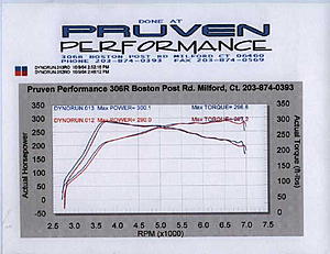

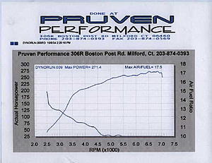

In tuning, I have learned that slow - steady - methodical corrections work best. I take small corrections at a time.
Attached Thumbnails Tuning with Dyno Flash - case study #6 - Member EvoJimbo-ej3.jpg

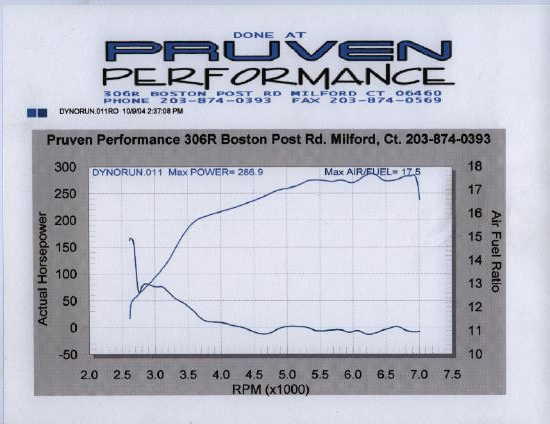

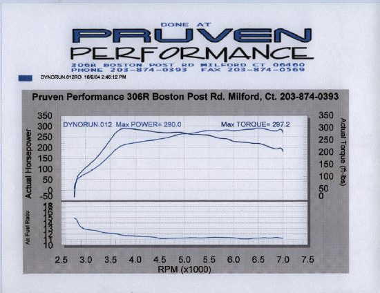

Steady as we go - starting to take shape with small a/f and ign corrections
Attached Thumbnails Tuning with Dyno Flash - case study #6 - Member EvoJimbo-ej4.jpg

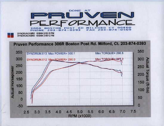

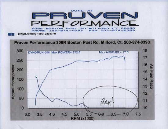

Very close - staring to smooth out - still too rich and will try a tad more timing
Attached Thumbnails Tuning with Dyno Flash - case study #6 - Member EvoJimbo-ej5.jpg

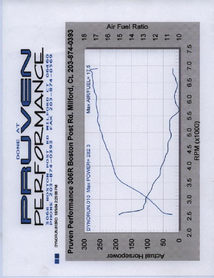

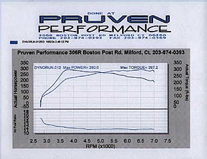

Things are starting to look very nice - we'll do another pass to back this up and make sure the car is not pulling any timing
Attached Thumbnails Tuning with Dyno Flash - case study #6 - Member EvoJimbo-ej7.jpg

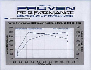

Back to back - picking up power - staying smooth thats what we like to see !
Attached Thumbnails Tuning with Dyno Flash - case study #6 - Member EvoJimbo-ej8.jpg

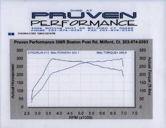

This is what we like to see - a wonderful running car on the road also - it was pulling smoothly
Attached Thumbnails Tuning with Dyno Flash - case study #6 - Member EvoJimbo-ej9.jpg

Although the power is good -the peak number is not my priority. Whats impresive here is the shape of the tq curve and the area to the left of the peak power point. This car is am amazingly great car to drive on the road and has a great "feel"
