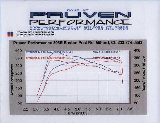

Another dual stage flash dyno sheet
Here is my latest dual stage flash dyno sheet
Mods on car were
Buschur intake filter
3" exhaust
Hallman MBC
Walbro pump
Buschur injectors
Hks 264/272 cams- (forgot to list them)
Red lines are 21 psi of boost - 93 octane with Dyno Flash dual stage
Blue lines are 25 psi of boost - 100 octane mixed in - NO Changes made to tuning - same exact dual stage flash
This car was so fast it spun the inside front tire all the way through 2nd gear - twice - (this was a first) - PS I love those '04 evos

Al Thanks that flash is awsome, and the idle flash is working great with my new cams, Just wanted to make a small correction, it was an HKS RS intake not Buschur, not a big deal but I know you like that intake and wanted to make sure people knew what kinda power you were making with it!

That is a beautiful dyno sheet. Wow! Very impressive Al! 355 HP on those minimum mods, that is awesome!

Al - I didn't think you could do a dual stage setup with the stock turbo.
I may have to look into this. I also need the idle flash update too.

This was on the stock turbo, correct??? I thought Al, said that it wouldn't work on the stock turbo cars?? Has this statement changed??

Yes it is the Stock turbo, some of the Mods listed were mistaken but it is a stock turbo.
