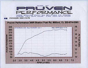

In this case we are not dealing with a car with extreme mods - just our basic every day type of street driven evo. The same car I tune day in and day out. I am posting this as a case study to show how hard work and long hours in tuning pays off with a smooth running and safe tune.
We are paying particular attention to this new crank pulley - in the past other brands have triggered knock activity

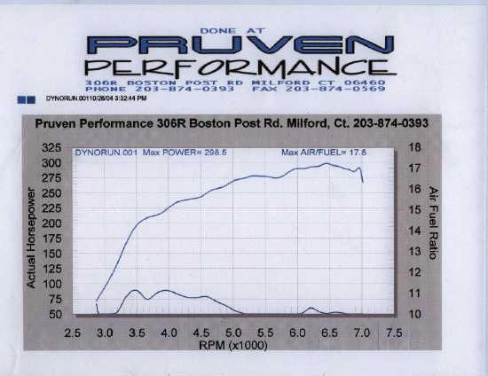

Here is our base flash - running a bit rich in this car - buit decent power - a typical safe through the mail flash
Attached Thumbnails Tuning with Dyno Flash - case study # 10 - Member DKTOP-cs101.jpg

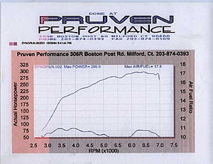

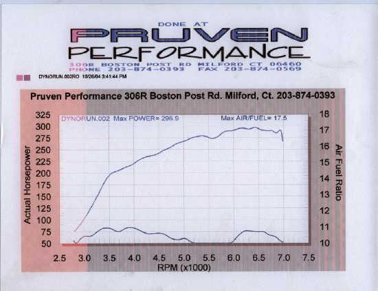

Here we are leaning out slightly
Attached Thumbnails Tuning with Dyno Flash - case study # 10 - Member DKTOP-cs102.jpg

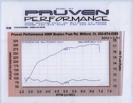

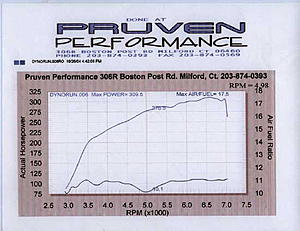

Step by step - slowly making "baby steps" to bring the curve in line
Note the significant power being made with a very rich a/f ratio
Attached Thumbnails Tuning with Dyno Flash - case study # 10 - Member DKTOP-cs103.jpg

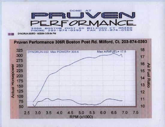

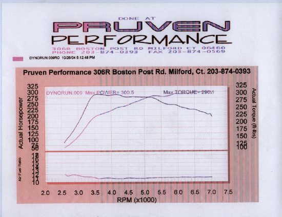

A little dip is left in the mid range and some timing adjustments to be made
Attached Thumbnails Tuning with Dyno Flash - case study # 10 - Member DKTOP-cs105.jpg

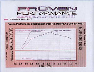

Almost done - things falling in line
Decent power - a slight timing adjustment needed and the persistant dip at 5,000

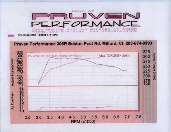

That dip is persistant - almost perfect
