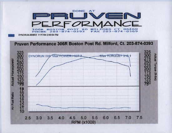

Here is my latest case study - just wanted to post the final dyno sheet due to time constraints today
This is member Nyredevo
His limited mods are
Injen Intake
3 " Exhuast
Walbro fuel pump
Hallman Pro MBC
and of course - fully custom tuned Dyno Flash
The Injen is a gret intake and a great value considering you get the upper fmic pipe included with the kit - good stuff
I have base maps for all the Injen set ups with and without cams
Of course - here is another dyno sheet of great quality and smoothnes and saftey of which I am very proud to place my name on

307/316? Nice #'s

That torque curve looks amazing! Great work as usual Al.

will the base flash be anywhere near these numbers? (same mods of course)

My base flash numbers were 289/287....he did a great job! Car runs smooth as stock (if not smoother) With a ton of extra power when i wanna put the hammer down. The car is right where i want it! For Now

Nice #'s, great job as usual AL......BTW was this on 93 oct?

yepp

The mail in flash makes about 10 - 15 whp less -oin this car it make 289 whp - still smooth but safter !

So if we already have these mods done and just get the mail-in for $199...we'll be putting down ~289WHP?

Approx - there is a significant car to car variance but that is the typical range. It is what it made on this particular car
