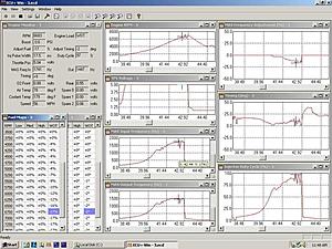

Al i sent you my ECU this past week to get the boost cut eliminated and i was ont he dyno this weekend and it was hitting boost cut all over the place. I cant go WOT anywhere because everytime at about 5k and 6500 it hits boost cut hard. I dont understand why this would be happening. Any insight?

There should be no boost cut on your car at this time.
When the "boost cut" hits - does it trigger a cel ? Have you read the cel's ?
Do you have a OBDII tool with freeze frame data ? Can you set to record data at time of cel trigger?
There are some other possibilities which may be cuasing your condition - such as spark

I havent gotten any SES lights or anything. I have grabbed a frame here and you can see when boost cut it happening. everything pretty much freaks out. Ill attach it in a moment. Also, ive had a spark blow out before, and it was nothing like this.

heres the attachment

al,
my humblest apologies. you were right, i decided to try out some new plugs that i had sitting around and the problem is totally gone.

What hardware/software do you use for those readouts and where do you get it?
Old Feb 28, 2005 | 02:00 PM
EvilDylan's Avatar
Posts: 499
From: Huntsville, AL
thats the ECU + piggyback
