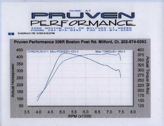

Here is member Kuba23's new dyno sheet FYI about the Gredy turbo kit which seems to be a real nice unit
Greddy T67 25G turbo kit, Dyno Flash, Alcohol Kit, 264 HKS cams, 3" Buschur Exhuast, AEM intake, 780 injectors, walbro pump
Stock fmic and fmic pipes, stock internals
pump gas with 18 psi boost

nice numbers...only 18 psi? Why so low?

Her is going for a built motor in 3 weeks - why push things? Also, on the stock fmic and fmic pipe I felt we were at a safe area.

How fast does it spool? dang that looks like a nice turbo.

18 psi 420+ whp on pump gas cant go wrong there hehe

4K it spools up

What spools up at 4k rpm's? Not your turbo. Look at your dyno sheet, you are making 100whp at 4k rpm's, there is no spooling going on at 4k. You might see full boost right below 5k which is about right for a 25g. It is a bad *** kit though and when it hits it hits hard. Not to mention it is priced competitively.

We mad a couple of runs and at one point when we Punched it at around 3 K the turbo started spooling at around 4 4200 somwhere around there i have like 4 dyno sheets in front of me one way or another i am 100% satisfied with the kit and i loved the 2 hour drive home hehe
