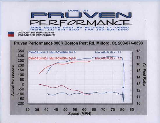

Here is a 2004 RS with new boost controlling flash
Mods were Apexi intake filter - 3" turbo back exhuast
as you can see on the base pull the intake was grossly leaning out the a/f ratio and causing a overly lean condition - we terminaed the pull easly as it was knocking. Remember - when you change to afremarket intakes they have the effect to distort the mass air flow sensor air flow and they alter the a/f ratio reading of the sesnor. This results in an overly lean a/f ratio and detonation which triggers knock induced ignition retard. Lean a/f and retarded ignition timing equals a very high egt and low power. Also not the best for engine reliability.
Our tuning runs much richer - adjusting the mass air flow sesnor to the selected intake and incresing timing - low egts and loads of tq.
The a/f on the final product is much richer and holding a perfect 20 psi tapering to 19 with just the ecu controlling boost

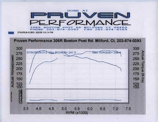

Final dyno sheet - boost is not as perfectly razor solid as with a hallman MBC - but its very very smooth and on the road the car felt very fast. In fact the car felt a lot faster when it was on the road than the dyno sheet would indicate - but a 47 plus whp gain is very decent for just a flash !

These numbers are no joke. I own this 04 RS that is represented here, and built it with the flash in mind. The intake is actually a filter from an AEM intake with the stock pipe. The AEM is made poorly, and I felt the pipe was only going to be worth a small amount of power. I will upgrade that in the near future now that I know it will help. The important thing with this is remaining at stock boost levels. I am regulated as to what mods are allowed by the SCCA for the class that I autocross in. My class dose not allow raising the boost. I told Al I wanted to stay at 20PSI which is the stock limit, and he controlled only the taper, If I am correct, and was able to get me close to 300WHP on pump gas. The car is now DAMMMMM FAST for the mods I have and Runs with better drivability than stock. AL YOU KICK ***.
