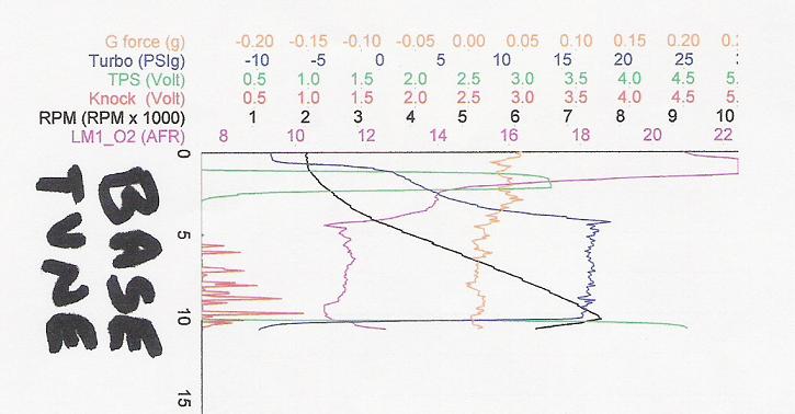

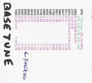

my base line data logs
here they are....
Attached Thumbnails street tune by al-base-1.jpg   street tune by al-base-2.jpg

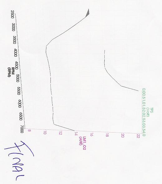

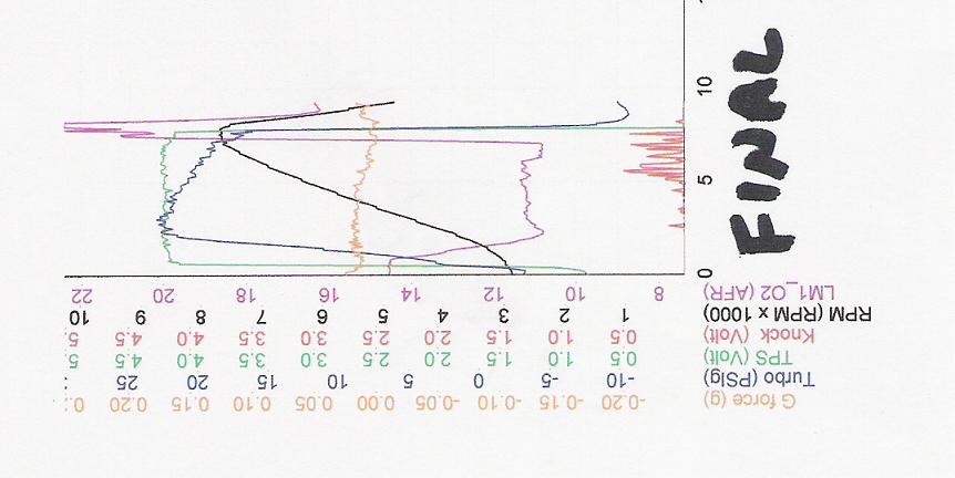

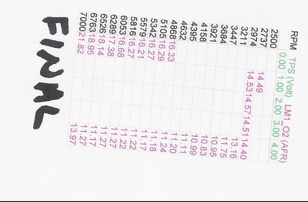

After Al Tuned
THIS car feel so much smoother and more torque and i bet much more reliable.
Attached Thumbnails street tune by al-final-1.jpg   street tune by al-final-3.jpg   street tune by al-final-2.jpg

On your car I made a mistake and did not have the G force meter properly configured
Now we have it worked out and I will be starting a chart of G force by modification
Its very nice when you see the Tq curve exactly follow the G meter -= very helpful in diagnosing flat spots in the power band etc
