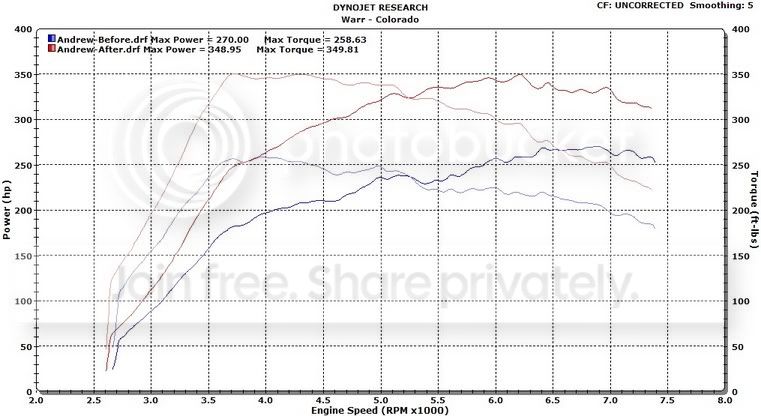

I'd say 340-350whp on a Dynojet.
Here's what a local 03 did with similar mods on one of our local Dynojets:
Before mods:
Forge UNOS MBC
HKS Intake (filter only)
Catless TBE
After mods added since first dyno:
GSC 272i/264e Cams
10.5 hotside
Ebay Manifold
Ebay o2
Custom Dynoflash
Btw, notice he got the same GSC setup as you, and that is the setup I'm receiving in the mail from GSC in a few days...
