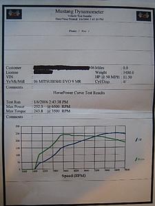

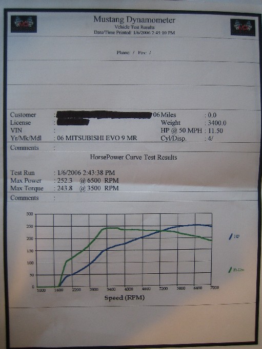

Here's my bone stock baseline on the same dyno for reference, also a IX:
FYI, I think cij911 hit a peak torque of 294 ft-lbs on another run, but didn't hit as high of a whp on that run as the 300.7whp run.
He gained almost 50whp/50wtq from upping the boost and the flash alone
Now post up the graphs cij!!!! I know you're technically and otherwise challenged, but come on!
Attached Thumbnails 300.7 Whp / 287.5 Wtq-dyno7lk.jpg
