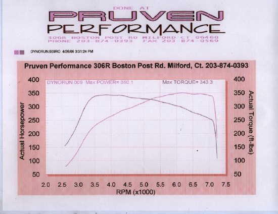

I think after nearly 3 years of daily evo work I am starting to get the hang of this flashing stuff
This car had some mechanical issues which needed to be sorted also - turned out to be a bad stock spark plug wire which was making the car run like garbage when it came in
This car came out perfect - this is how a dyno sheet should look
And, a joy to drive as well
IF he had the 10.5 hotside it would have been even better

Nice numbers. Curve is pretty sweet as well. How long did it take you to figure out his wires were bad? I would imagine as long as you have been working on it that it must have been pretty quick.

350whp with a 9.8 hotside nice tune Al
First we swapped out his MAF sesnor from another evo
Then we swapped in coils and plugs from another evo
Then we pulled one coil and wire at a time and put back on his parts till we found the bad one
Good thing we had a donor evo !
Ralliart or stock are the only plug wires to replace it with

Nice #'s?
What do you mean? 2 years ago 295whp with those mods would have been nice, this guy is at 350 whp/wtq - Thats insane!

hey al how much more would he see with the 10.5 you think. i installed mine saturday finally. The mods in my sig are either on the car or on the way. what kind of numbers do you think you could pull with a custom flash.

very smooth curves....and the power output is very impressive for those mods without alky or race gas
what is even more impressive is that this was on pure pump 93..I made 376 with alky and basically the same mods....

Every car is different - having the right combo of parts, properly installed and without boost leaks is the key to extracting great power
right after this one we had a car with 280 cams and BR Stage 2 which was 30 whp lower due to a restrcitive high flow cat which seemed to be cloged
It all comes down to the individual car and the experience to know how far each car can be pushed safely
