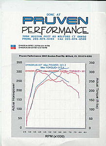

We ran across yet another Evo with crank wheel problems - its facinating if you comapare this guys lightweight crank pulley dyno sheet to the other guy we posted up the max power WITH the crank pulley is just about the same - 305 whp
The mods were 3" exhuast, HKS 264 cams and intake with MBC set to 20 psi
With the crank pulley he was having issues with a rough power band and not too much power
When he was in for his initial Dyno Flash back in October, he wasn;t doing that well on power - we thought he must have had a bad load of gas as we saw lots of engine noise and the knock sensor was pulling timing on the stock ecu if we tried to go over 310 whp
At that time - we were unaware of the Crank Pulley issue and we also were unaware that he had crank pulleys installed
Here is the AFTER dyno sheet - I know this is a bizzare order but I messed up somehow - anyway - this is a real smooth and nice dyno sheet - very rich and conservative in a/f and the car runs like a BMW M5 - lots of low end power and pulls smooth to red line

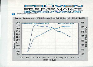

Here is the before with the lightwieght crank pulley and original Dyno Flash settings with the ecu having taken out lots of timing and created this super rough power band VS. the After dyno sheet - you can see the gains we could tuen back in without that crank pulley adding all that harmoinic engine noise
Again, this virtually duplicates the other guy's results both in pre and in post dyno numbers

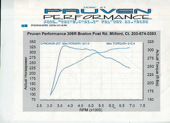

With and without the pulley - never removed car from dyno - note pulley was on first and did make a 6 ft lbs trq increase down low - OR shall I say putting the stock pulley back on cost us 6 ft lbs
Its nice to see some gains on the dyno from the pulley
The PROBLEM is that with the STOCK knock function and sesnor intact - the extra harmonics from the pulley are causing false knock readings which makes the ecu pull timing and lower the power while making the power band rougher
IF you used a ecu with knock correction - desenitization - like a stand alone - then the harmonics would not effect the tuning and you would not suffer these probloems
I am posting this information becuase the DYNO FLASH is a stock ECU based tuning option which uses the factory knock sensor and when you are using the Dyno Flash it is NOT a good idea to add a crank pulley
I am NOT a mechyanical engineer so i am NOT commenting about bearing issues or other mechanical issues that others have discussed
Its clear that the pulley itself made power - the ONLY issue I am warning about is the stock ECU knock sesnor seeing more harmonics and noise and the stock ecu pulling timing

Runs 1 & 2 were with the aftermarket pulley - - - RUN 3 was made eaxctly an hour later after the pulley was removed and backl to stock - the car was not run in between - that hour was the pulley removal
We did not reset the ecu - the pulley was just removed and another run was done
The next time this comes up - just for kicks - I am going to do the A-B pulley test - THEN reset the ecu and redyno
As far as your pulley - I am glad you have good results.
I have seen this same low whp situation on many cars with pulleys and I am only posting this info b/c I do not want ANY of our Dyno Flash customers to go through this
My original findings and dyno sheets were questioned so when the chance came to do this again I jumped at the opportunity
People reading this stuff can reach their own conlcusions - however - the numbers are comming up exactly the same on numerous cars - even after tuning by other tuners on other dynos
BTW - we have not commented on any particular brand pulley that was used and in fact I do not know which pulley brand it was - I dont think it matters - IMHO a solid disk crank pulley is a bad idea on an evo
Trust me when i tell you if we were getting more power with these units we would be selling them to our customers so they could make more whp - AND - i would have one of them on my Evo as well
