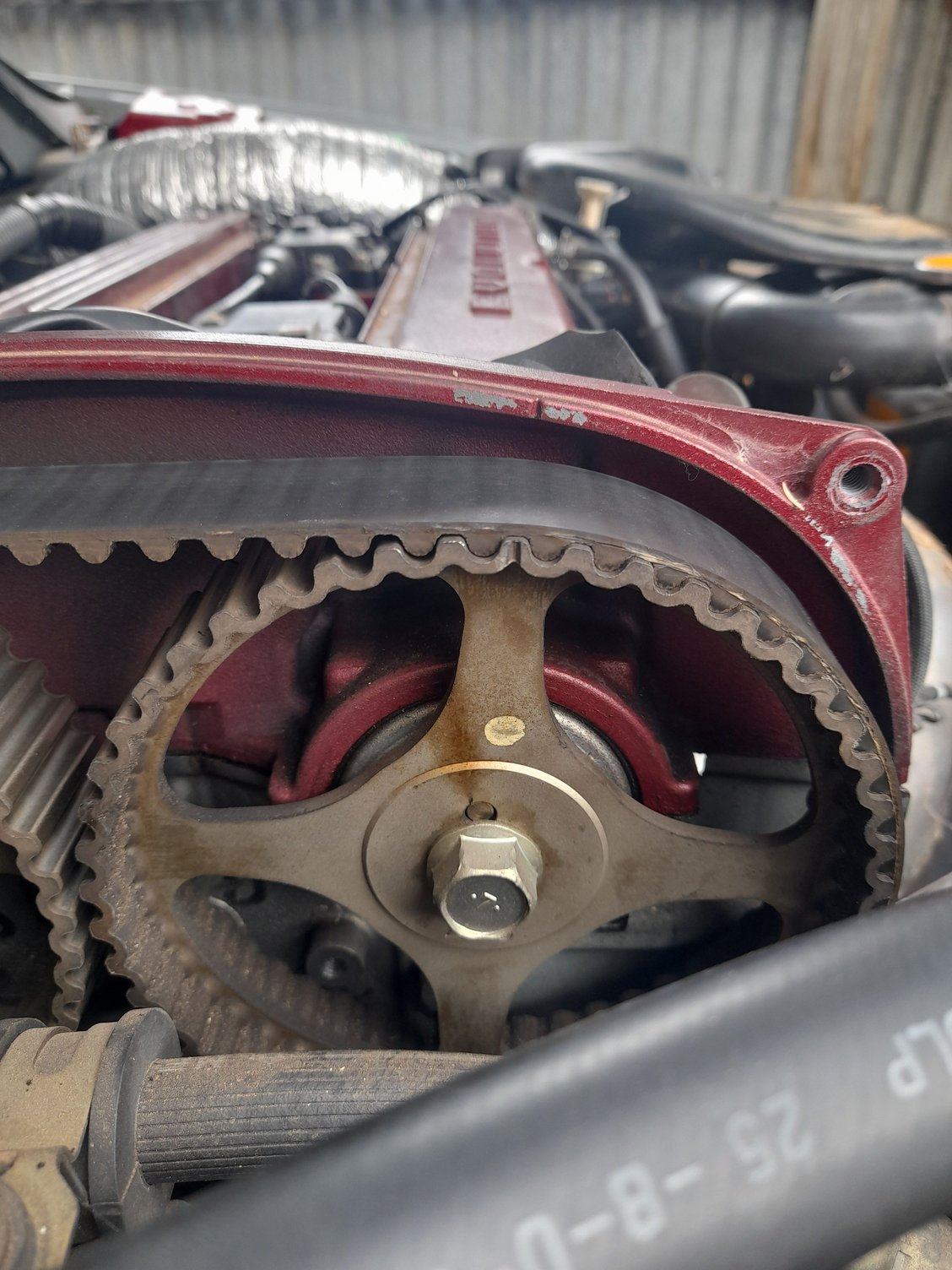

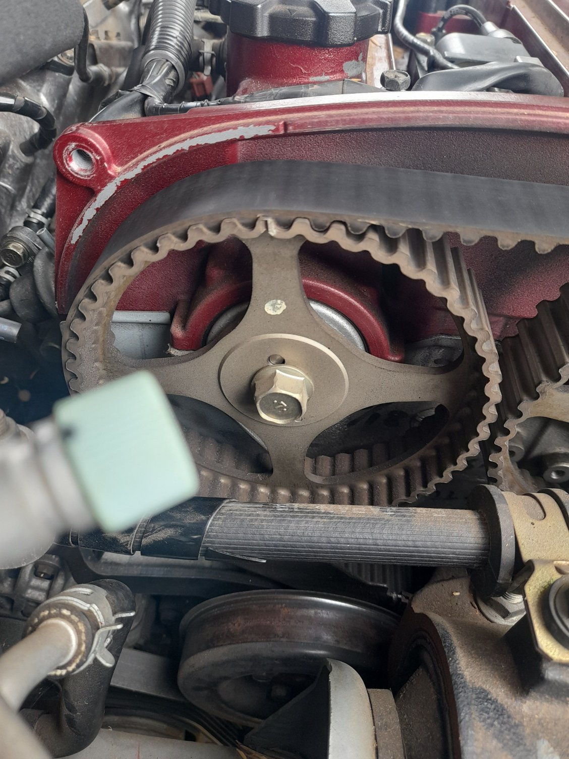

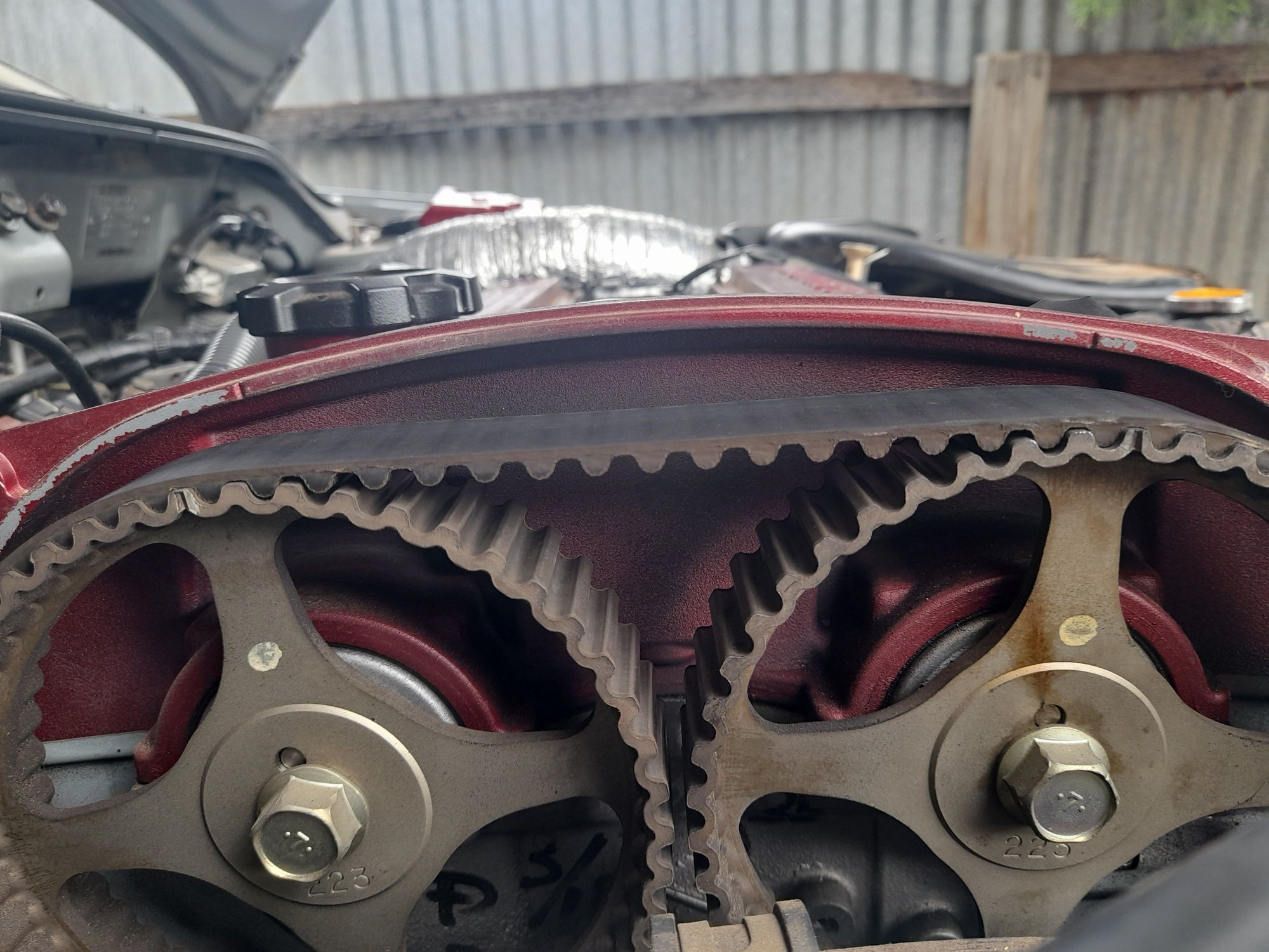

Finally get the time to get jack stands under the bishi to turn it over by hand to check the timing marks all lined up, f**k you need xray vision to get a perfect alignment on the crank pulley but tell me if I'm wrong that should be -5 degrees BTDC the cam marks are slightly off both intake and exhaust rocker cover marks. As you can see in the photos. But I feel like that means it's retarded rather than advanced. I'll put up a short video of cranking today aswell. I feel like I'm missing something simple

^ Uh oh, yea now im seeing a timing issue. It seems engine cant build compression and startup. There is smoke so you're getting spark and fuel. appears hydro locked or bent valves would do this. Will it not continue to turn over if you hold key in the start position?

yup that skipped

okay yea, skipped timing. Time to start disassembling the head. If it didn’t bend valves the car would still start with rough idle. Unfortunately with a no start it means it needs a rebuild.
