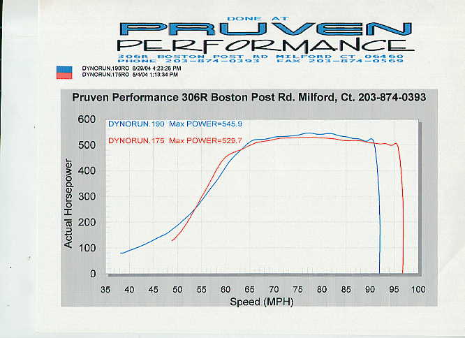

Hey guys
Here is a comparison of my old 3037S HKS turbo set up vs. the new 3040 Turbo - only changes are the addition of the turbo and the bigger 1,000 injectors
Old boost was limited to 28 - 29 psi max
Now I am hitting a peak of 32 falling to 30 with a couple of turns left in the boost controller
For the first time, I am literally spinning the tires on the dyno - its starting to make some serious power
I can not wait to get to the track and see what it will do
BTW - I do not wish to speculate how this awd dyno jet compares to 2wd dyno jet numbers which some people are using and I certainly do not want to speculate about how much this would calcualte into so called "moon dyno" numbers - - I perfer to just let the numbers speak for themselves
PS - I drove in at hour in rush hour traffic to the dyno and drove it home - not bad for a 2.0 L street driver !

As you can see the trade off here is a bit more turbo lag for a very significant gain up top
I had to end the dyno session early so I could not max it out - but since HKS rates the 3040 with 30 more PS than the 3037 - I think we are realizing the appropriate gains
The old 529 who dyno sheet is certainly smoother as it was road tuned and I took my time on it
This one was done in a rush and most of the sesssion was spent adjusting my boost controlelr and re-routing the vac hoses
Another 10 - 20 whp is in this set up

Is that on race gas? Also most good power bands rise with RPM's. Also you say your car is a everyday driver, how is that? It will not pass emissions and has a damn cage in it lolrof.
So you are saying that a "good"power band has to rise as the revs rise?? Why is that ???? You only want to deliver peak power at high rpms ?? Is that good ?
To me, the idea is to make as much power as posible all the way across the power band. Our goal is to make 550 whp and more from initial spool up to 9,000 rpms
Its useful to have as much power at low rpms as you have at high rpms
As for the gas - of course we run race gas - I have two 55 gal drums of it
About the roll cage - the side bar is removeable so once you take it out it is like having a car with no cage
