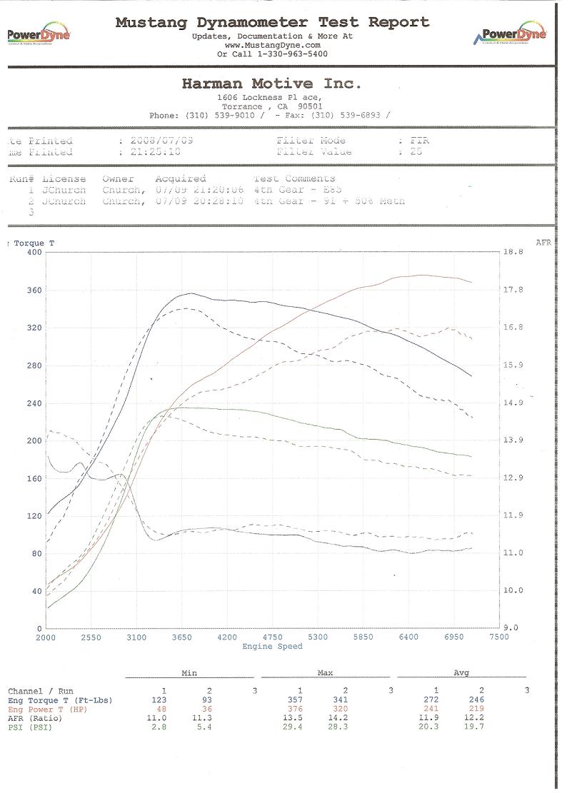

Another Evo IX FP Green with E85
Gained 56 max hp and 16 ft-lbs of torque on E85 vs 91+50% meth. Both tunes were done consecutively on the same dyno at Harman Motive in Torrance, CA. Huge thumbs up to Dan H and Scott B! The quality of their work and tuning is top notch. Quality of work and customer service is the best I've had in SoCal.
E85 - 376 hp & 357 ft-lbs tq
91+ 50% meth - 320 hp & 341 ft-lbs tq
For reference: was told that the new GTR did 405 hp on the same dyno
I was amazed how smooth the E85's hp and torque curves... The car is my DD and a blast for street driving.
My mods include:
FP Green ported turbo w/FP actuator
RC1000 injectors
Agency Fuel Rail
FULL RACE exhaust manifold (tubular)
HKS 272 MIVEC cams
65mm Mil Spec TB (ported)
Sparco Intercooler
Springs & Retainers
Horsepower Freaks LICP
UICP
AEM meth kit
ECU load boost control
HKS DLI II
TiTek O2 housing
Walbro Fuel Pump
AMS small battery kit
K&N Intake
Full exhaust w/test pipe
HKS Ti Carbon muffler
Buddy Club grounding kit
DEFI gauges (EGT, Boost, Oil Pressure)
Labonte flow gauge (for meth)
AEM A/F gauge
GM boost solenoid
JDP map sensor (for logging)
Stock ECU (flash w/ alternative map switching functionality)

Hey I just stumbled upon this thread while dreaming about e-85 coming to my area and I figured there would be more power with the green setup. Are you pushing the tune very hard? Maybe I'm just expecting too much from E-85 or it's just a difference in DLL settings. I'm about 300ft above sea level but don't do any SAE correction and use a conservative 165lbs for the driver weight for what it's worth. IIRC DLL was more like 395-405 in the summer heat and humidity.
I don't have a green anymore, stepped up to a HTA 35R but this was one of the last DLL's I did before the swap.
mods at the time were:
93 octane
26psi spike (tapering horribly as they do)
hks 280 cams
br deluxe fmic and pipes
br 3" turbo back, test pipe and bullet muffler
br ported stock exhaust mani
ss 02 housing
my tuning of course
I know it's not a good idea to compare DLL from car to car but it's all I have. I did trap ~ 118 with the green on 93 octane fwiw. If you have one I could run your log file through DLL to try to reduce the variables.
It does look the the 3500-4000rpm torque is way better on e-85, likely because you can run significantly more timing there.

You know as well as I, comparing dyno numbers between cars isn't always a good idea. Comparing DLL's is even worse. There are just TOO many variables. So if I were you i wouldn't be paying too much attention to the differences between your graph and mine. It's oranges and apples...
You will definitely pick power by going from premium to E85. You may also get faster spool-up, which i'm sure you'll appreciate with a HTA35r.
I picked up ~40-50whp/tq by switching to E85 on green, that's what matters!

churchja, as I said in my PM but just have to say again here, I can't get over how great your dyno graph curves look. If there has ever been an example of a FUN looking dyno graph that speaks volumes for powerband > peak numbers, that's it.
I also really appreciate the true back-to back comparison with meth. If I ever upgrade, I think between you and Mplspilot's results, I know exactly what I want. Congratulations and thanks again for sharing.
