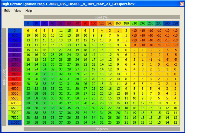

Ok, I updated the original post with some images. This is what I am looking at in evoscan and then what my tables look like in ecuflash.
From my understanding I upped the load for the boost cut so I really shouldn't be running into that. Are there hotter plugs to run for the IX? I have only read that the stock ones run in the IX. Should I gap just a little on the tighter side?
Oh, and I just realized something. Even though the load in evoscan says that it is 227 @ 5k RPM how is it running at -1 timing? That would lead me to believe that the actual load that the ECU is reading is probably @ 260 where the timing advance is set to -1. If that were the case then it would look like I am running into boost cut.
Please somebody that knows more than me please chime in. I will advance my timing a bit in the higher load/RPM but it looks like there are two approaches when dealing with the boost cut. Up the delay time from 1s to 5-7s or up the load slightly for the given RPM. Any good argument on which or should I even need to do this?

Yeah, that boost cut level is set too low. raise it way more. mine is set at 305 all the way to 5500 rpm and 280 by redline. Yeah, My load level is that high, I am hitting 290 ish at peak and tapers down to 260. If you have an MBC, just set it all the way to 319 and test it. MBC is pretty reliable. Also, don't forget to raise more timing values. especially on that -1 area.

Ok, that did the trick had to up the load for the boost cut to 280 at lower rpms tapering from 5k-7.5k to 265. Boost is at 26psi and looking good with my problem solved.
