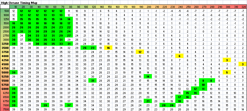

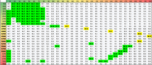

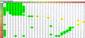

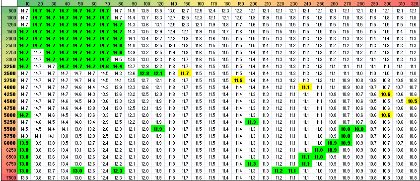

I was wondering if I could get some help with an issue that I'm having. It's nothing major but I would like to learn how to fix it or what I'm doing wrong.
I'm getting knock during spool up/load up, nothing terrible 1-2 counts of knock, but it is annoying seeing those blemishes There are times when it is more excessive 3-4 counts, but it isn't consistant.
I'm pretty sure it has to do with how rich it's getting during spool, although I could be wrong. Here's some pics of my maps and where it's doing the knocking.
Any help is always appreciated.
Attached Thumbnails Knock during spool/load up-e85-timing-map-tip-knock.png   Knock during spool/load up-e85-fuel-map-tip-knock.png   Knock during spool/load up-e85-actual-afr-tip-knock.png

I'm going to try to lean it up under spool and lower the timing just a bit in the knock areas.. I'll report back tomorrow.
Edit: Figured it out...I was running too rich under spool and just a tad too much timing. I lowered the timing in the neccessary areas and leaned it up a fair amount. Problem solved and she runs even stronger now.

I lowered the timing a few degrees here and there on the spool path, along with leaning it up a tad. That cured the WOT pull tip in knock, but not the part throttle "kinda goin" situation. I thought this could be a fuel issue too (e70 as oppposed to 85). The stations are now carrying e78 blend. That has helped just a little, but not a lot.
I cant get rid of it no matter what I do....I guess I'll wait till real e85 is in town again and see what happens.

You should be able to run upper 12s AFR during spool on e85. Looks like you found the issue though...too much fuel.

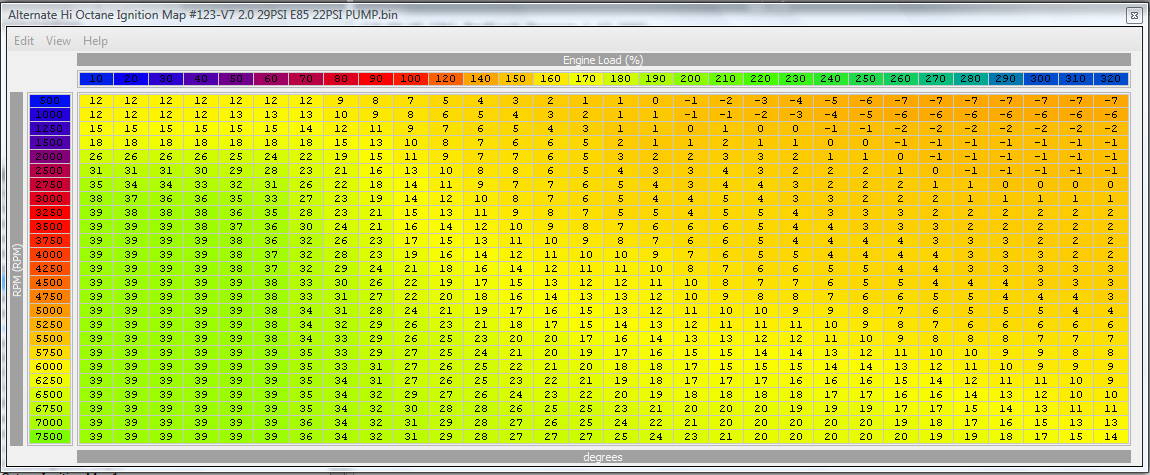

Here is my new ign map with a little decreased timing in spool areas. I believe that leaning it up had more to do with the cure than the timing, but it cant hurt.

^ since you are on e85 you can shoot for a little more timing at peak load...i.e. 5 degrees or so. Also, as I said earlier, E85 can run quite a bit leaner and still make power...i.e. 12.8-9 during spool and 11.8-9 for the rest of the pull.
Are you certain that the knock you see is "real".
