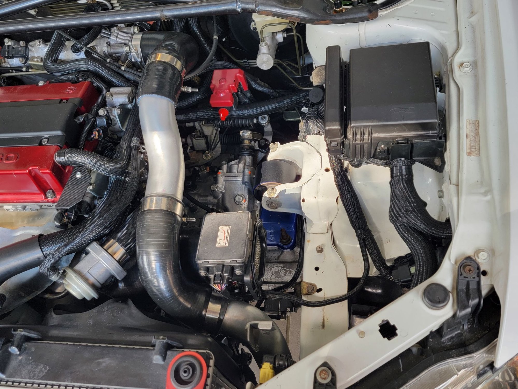

if it works, my attitude is just to tuck things away, cap barbs and disconnect & zip tie connectors, extend/cut hoses/wires etc
buy some nice silicone vacuum hoses (i wrap mine with those braided wire loom thingers) and buy the tiny zip ties, some shiny clamps kits.
I enjoyed cleaning up battery wiring the most since i've been fighting those cables for years. have fun

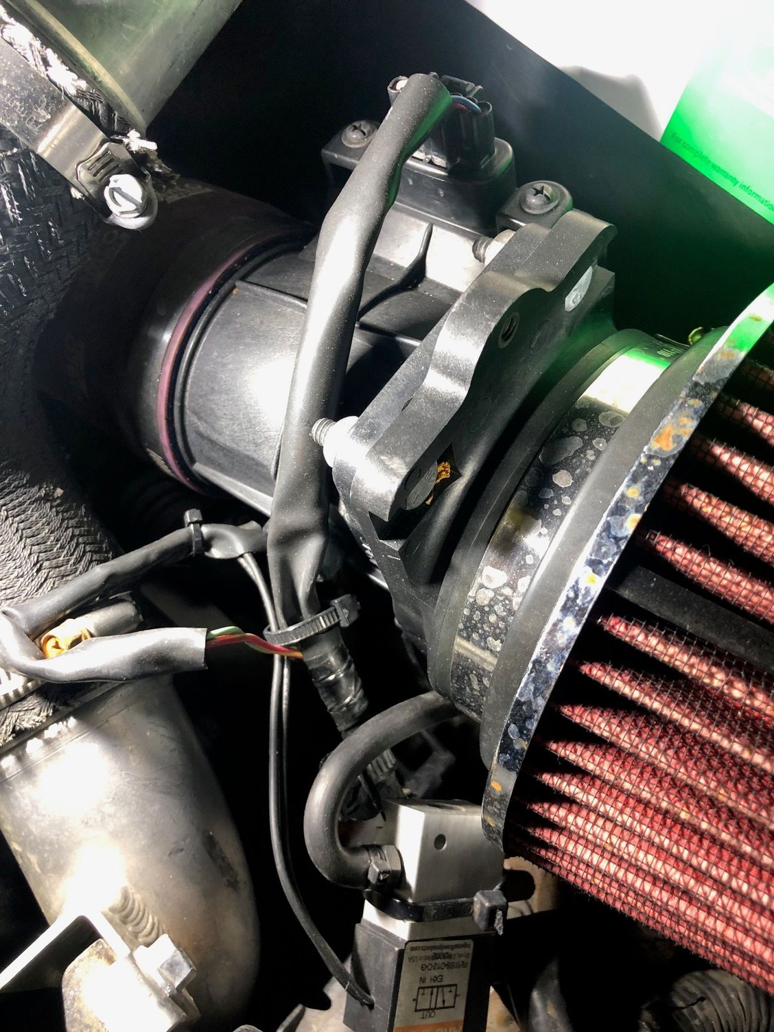

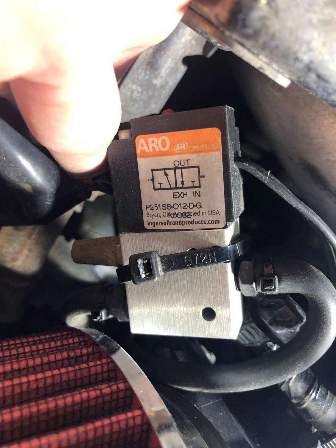

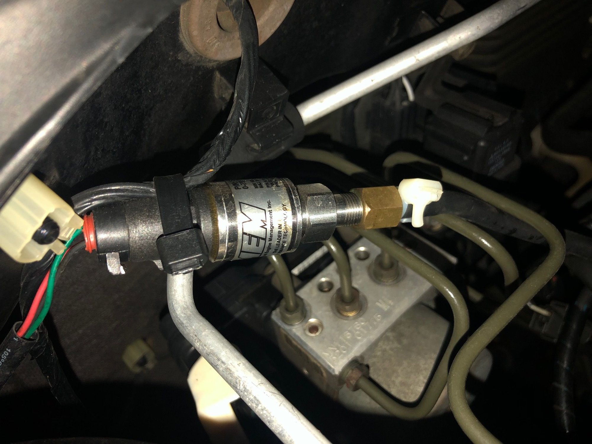

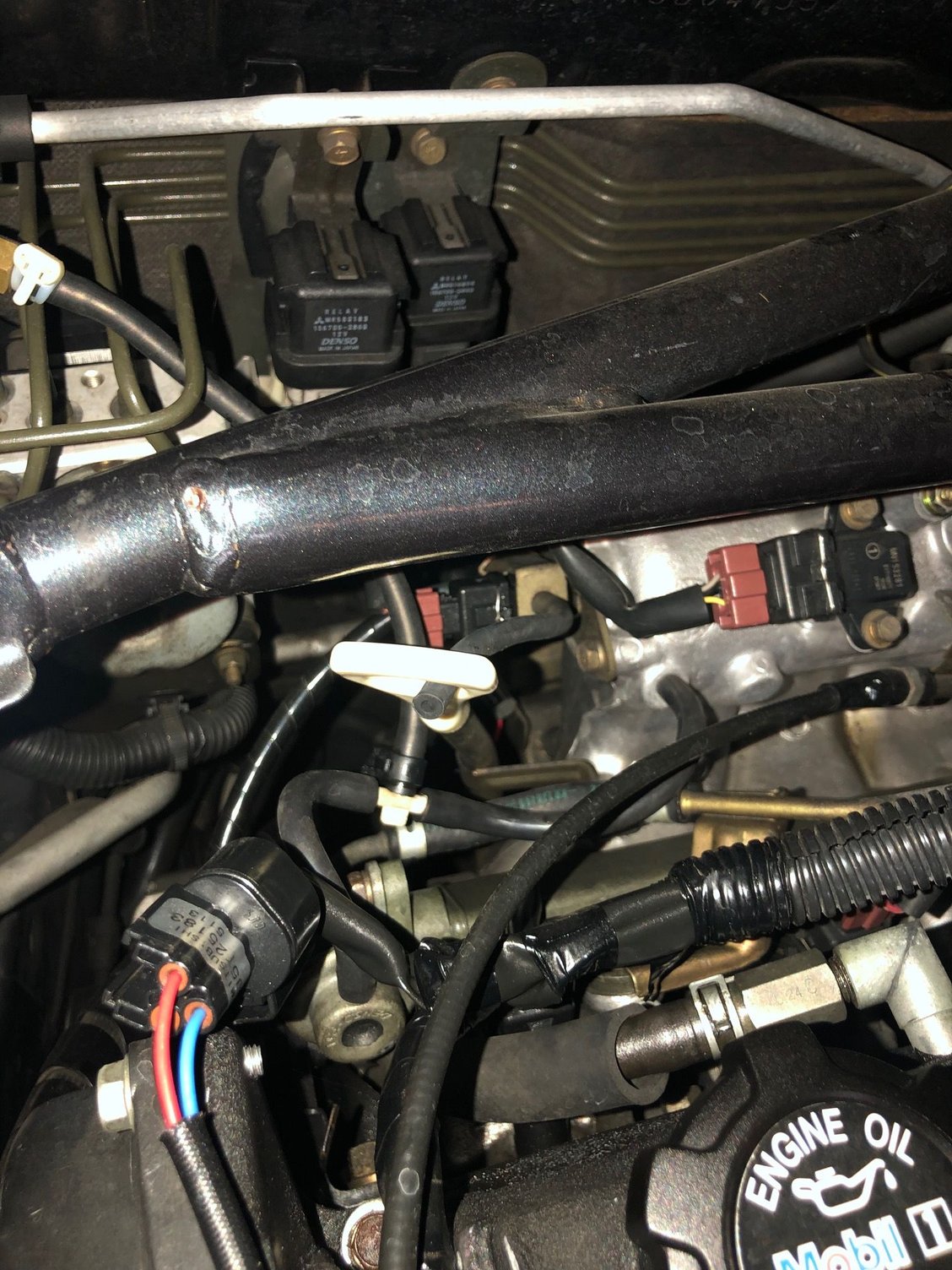

I think the first 2 pics are of the boost gauge sensor? I suggest to remove the tee (leave the FPR alone) and tee the hose to the BOV. Maybe hide that sensor behind the intake manifold
I think the next 2 pics are supposed to be some DIY boost controller?
