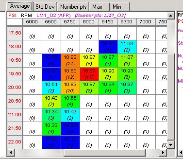

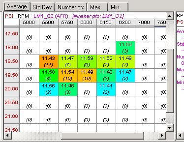

I've been able to tune to a consistant AFR in 2nd - 4th gears at the track and on the street. I believe the reason for the difference is due to how the car 'loads' (or how boost builds) during a drag pass vs. during a 3rd gear pull on the street.
You are in different load cells which is why the A/F ratio is different.
Yup, this is exactly why I said a log banging through the gears will be different then just logging single gear pulls.

Here are my test results. I have done about 5 full 3rd gear wot pulls and shifting to 4th gear and going WOT until approx 6300 rpm. In each and every one of them the AFR in the 4th gear was richer than the AFR in the 3rd gear. The 5500 rpm point in 4th gear is the spool up point after the shift. That is why it dips well below 11:1. Here are the relevant rpm sections:
3rd gear
4th gear
Attached Thumbnails AFR consistency per gear?-afr_3rd_gear_5.jpg   AFR consistency per gear?-afr_4th_gear_5.jpg
