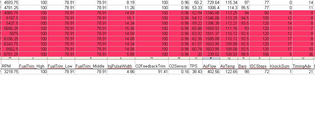

So far at 60% throttle between 5 adn 6K I get a few 14 counts then one 16 and one 17.
Man, that's as much as I was getting. However, I think my knock is from too high of boost and bad gas...
Damn and your barely at 60% throttle, man you got some tuning to do, be careful lol

I wish I could post my maps but this is a EcuTek flash. I love the way the car feels but that knock is scaring me! The funny thing is at 99% throttle I am see counts of 12.
Dam and I get scared of 1 count. I am certain though 1 count pulls timing, unless ecu is configured otherwise, because when I had 1 count my timing was 6,6,6,4,6,6,7
