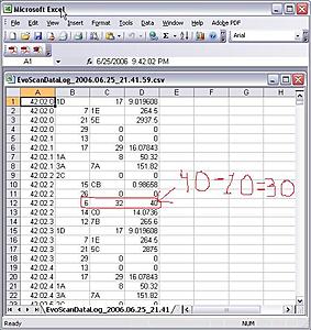

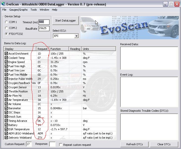

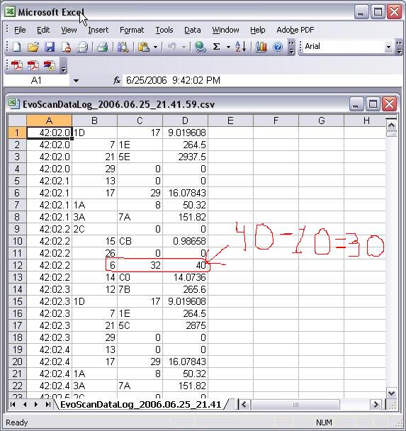

There was someone that said they did something to the CSV file to make it ledgible... anyone?
I just need to see my timing for now... don't really care about anything else
EDIT:
Actually that was on openecu forums.. tryine to dig the post up now.
http://forums.openecu.org/viewtopic....asc&highlight=
torward the end I uploaded a xls file I made with a excel graph and timing corrected
look at the evoscan program in the items to data log window it lists the items and a request hex # for timing is, 06 now open the csv file with excel and look in colum B for "6" the data in the cell next to it in column C next to that cell is the ecu hex coded response and the next cell to the right in column D is the "translated for human" value. note at this time the advance # is wrong it looks like it is 10 degrees off, subtract 10 from that value in the D column and that should be your timing

Attached Thumbnails evoscan logger release-screenhunter_6.jpg   evoscan logger release-screenhunter_7.jpg

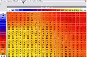

At 16% throttle at 2900 RPM I would be expecting about 40 degrees on my timing maps. I'm away at present, but will try to do some logging in about 20 hours time.

the most advance my maps have is 38, my maps dont even have 40 on them, they are still stock until I can reliably log everything including wideband o2
if you look 30 seems about right at 50-60% load. when you barely touch the throttle on my car at 2900 the boost is already starting to build

that peice of log in the picture just happened to be a fraction of a second of the log that I started while cruiseing at 25 mph getting ready for a pull. what is being discused is how to read the log and ignition timing accuracy in the log.
aside from that you also want to log differnt driving conditions so the entire map can be tuned not just wide open throttle. that way you have good drivability and hopefully better fuel economy
