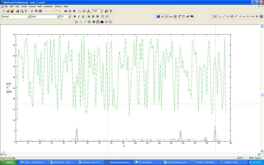

I did a spirity driving run and am seeing some knock. This is on the factory map with a tbe drop in filter and mbc (@21psi peak). Check in out I plotted knock, timing and o2.
