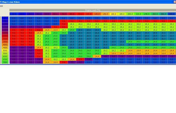

Here you go john !
This is from a JDM Evo 9 RS totally stock ..
have fun matching it ! Let me know what's the difference ..
Hey if you have any other info .. please let us know

I have only been focusing on the upper reaches of the map at first, but above 6000 the 0* portion of that map (100-300 load cells) definitely benefits from more timing. Deadspot is almost gone above 6000-7000 range.

Thanks gunzo, will have a play

What I have noticed is that the map goes in steps of 4.8. 1st things first are we sure that this # translates directly into degrees of advance/retard? 28 degrees seems like alot of range.
