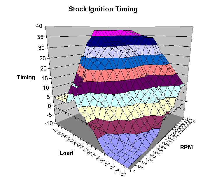

Here's a nice 3D representation of the stock timing table... notice how as load and RPM are compared, the stock ECU timing table follows a smooth ramp up of timing as RPM increases... the 3D representation makes this eas to see...
When you adjust your timing cells you want to make sure that the ramp rates between cells aren't too drastic. This could lead to all sorts of problems... a sudden "safe to knock" transition and a rather non-smooth seat of the pants feeling as you traverse different timing cells (rolling on and off the throttle rather than treating the gas pedal as an on-off switch).
