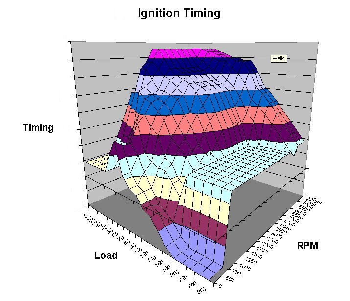

Here's an example of a ignition table that wouldn't feel very smooth when jumping from the 180 to 200 load regions at 1250rpm (sudden increase in timing that could result in knock) and at 5000rpm (sudden drop in timing that could feel like a rapid loss in torque).
I purposefully left the timing values out so you couldn't recreate this table yourself.

Here's a nice 3D representation of the stock timing table... notice how as load and RPM are compared, the stock ECU timing table follows a smooth ramp up of timing as RPM increases... the 3D representation makes this eas to see...
When you adjust your timing cells you want to make sure that the ramp rates between cells aren't too drastic. This could lead to all sorts of problems... a sudden "safe to knock" transition and a rather non-smooth seat of the pants feeling as you traverse different timing cells (rolling on and off the throttle rather than treating the gas pedal as an on-off switch).
Im not an expert but I personally don't feel that this graph is a good method to judge the quality of a timing map. Dont ask me why - I dont know, but I do know there's so many more important factors at play than load vs rpm
That type of map is not optimal for several reasons, IMHO:
1.) The flat timing ranges basically assume that at 200% load you can run the same amount of timing as you can at 260% load.
If you take a moment to think about that, it doesn't make sense. Simply put, the ECU calculates the load value based on the mass of air being pushed into the engine. At 260% load value you will be pushing more air into the engine and (hopefully) mixing it with more fuel, resulting in a more powerful combustion (more fuel + more air = bigger release of energy), which means that you should be able to run more timing at lower load values.
2.) Sudden changes in timing, no smooth transitions. This can cause detonation, both from a sudden increase or decrease in timing.
3.) It is very difficult to log against flat timing maps. If you logged 5 degrees at 4000 RPM and your timing table shows 5 degrees from 180% to 260%, then it makes it very difficult to pin down exactly where your ECU is running through its maps

Timing curve is suppose to be a smooth transition as load increases and with that graph he is showing the difference between a well adjusted timing map and poorly adjusted timing map. If you have seen the aem software, once your timing map is adjusted properly and you look at in 3d you will understand as the graph will be smooth as butter.
A graphical map is highly useful to make sure that you do not miss any cells and also to help shape the map
The taget numbers under load should be determined through dyno and road logging and then you can use the graph to smooth things out
Flash Evo by Ecutek has some great 3 d maps you can spin about in all directions and its very helpful
Aem is the same
