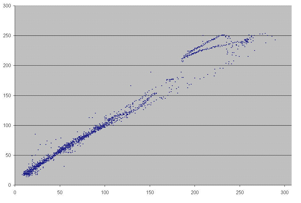

Correlation between the airflow/RPM*852 and the "load". Note the anomaly at the top is because the airflow clips at just over 1600 Hz.
