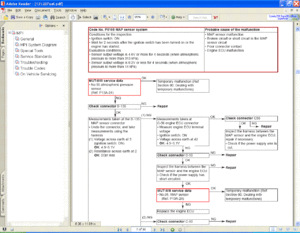

It is a 3 bar MAP sensor!
See attachment. I became suspicious when I remembered that I was seeing 4B with the engine off, which seems to tally with the normal voltage range for the factory MAP sensor. So I unplugged it and it went to FF.
So this is the reason some of you with a 1 bar MAP sensor are pegging the &H38 request ID as soon as you go onto boost.
Nice to know it is there then, and the scaling from the service manual shown is MAP (KPa) = 1.334x assuming the supply rail voltage to the MAP sensor is exactly 5.0V. You'll need to work out your own 1 bar MAP scalings from your service manuals or by experimentation.
I'll put more work in on finding other stuff this week, I'm not giving up on load yet.
However, knowing high speed boost logging on your maps is a pretty close correlation.
