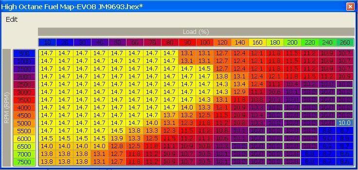

Originally Posted by MalibuJack
But generally the maps are so rich, that you can remove about 1 point of fuel from the 9:0 and richer portion of the map at high RPM if you set your boost for about 20psi.. That alone should pick up 20-30 hp and still be a safe tune. As you play with different boost settings, and AFR's, you affect the timing you can use, and vice versa...
like this? sorry for the clarity, i basically mad all the 9:0 , 10:0 and left all the 8:0 alone.

You can lean out the 8.0's also.. But depending on the boost levels you may not get into those cells..
