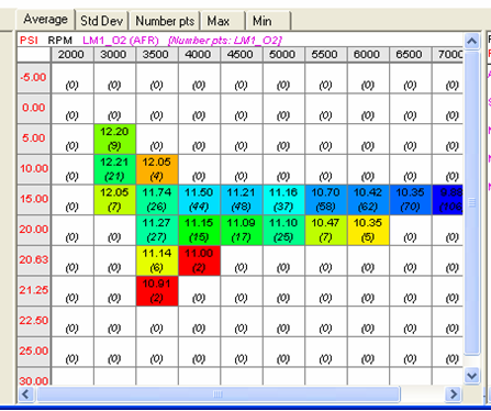

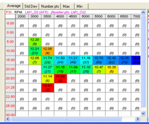

NJ, you're way off. The stock AFRs at peak boost are VERY LEAN at around ~12.5. Why did you think they were in the 10s? The stock AFRs don't drop into the 10s until after 5500rpm. The stock AFR profile starts very lean before and during spool, then it gradually goes rich as RPMs rise.
You are wrong. I have logged my AFR WITHOUT the Xede 7 times and found the majority of AFR point at 20-21 psi around 11.2 or less. It is nowhere near 12.5:1. This with with a stock ECU. You can see the pic of 7 WOT runs and the AFR at peak torque/boost, ie, 3500 rpm is almost always below 12.
Go look at Shiv's tuning even - VERY LEAN at peak boost. 6-8* at peak boost gives awesome torque.
Wrong again. Here is a run with Shiv's off-the-shelf map BEFORE I modified it. You can clearly see that the AFR dip below 12 at peak torque/boost.

Well, I don't know what that first thing is saying,
Look at the third column from the top the one that says 3500 rpm. Now look at row 20 psi, 20.63 psi and 21 psi. These are the peak boost rows. Now look at the cells and you will find the AFRs that correspond to the rpm and peak boost. What do you see in the cells? You see an 11.27, 11.14, and 10.91. These numbers are averages of the 27 times, 6 times and 2 times that the AFRs hit the corresponding psi @ 3500 rpm.
This is the SUM of the 7 WOT runs that I have done on my stock ECU. They are nowhere near 12.5 AFR at peak boost/torque like you have said. What you said is incorrect.
The AFR dynograph from the dynojet are NOT accurate and they are tkaen at the tail pipe. They are generally 0.3-0.4 too LEAN. So when you see 12 AFR it is actually 11.7-11.6 AFR.

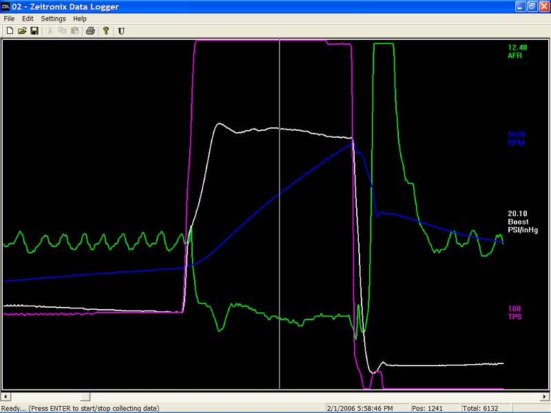

It is an innovate and it is located in the downpipe 18-20 inches from the O2 housing. I have 75 logs and all of them read the same at peak boost/torque regardless of whether it is a stock ECU, Xede tuned by Tuning Tech or Xede with Shiv's map.
I know other have logged the same thing. Check out this log from Evo_Kid's Zeitronix. Notice the dip in the AFR at Peak/boost. This log was taken when Evo_Kid had an Xede with the same Shiv map that I am using.
Nothing is wrong with my Innovate since other have logged the same thing with other AFR devices. It is just that Warr was wrong and he does not want to admit that he was wrong.
