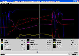

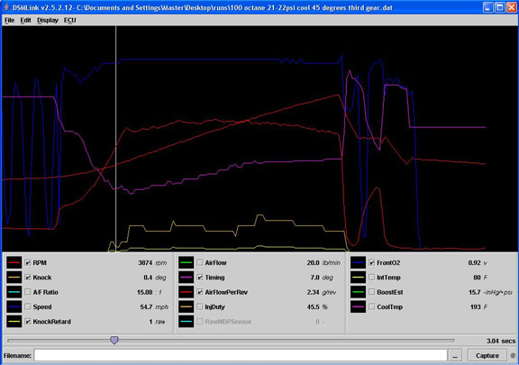

nh1266,
OK, just to try to satisfy you, which this probably won't, I looked through my old DSMLink logs that has some knock in them. Here are a couple screenshots of the logs with only a few parameters checked so to help clean up the log. The first screenshot shows the cursor at an area of 1 knock count and the second shows and area of 7 knock counts. The first shows the timing being pulled as .4* (client rounds to the nearest tenth) for the 1 knock count and 2.5 * for the 7 knock counts (7 x .35*).
If you want, download and install the DSMLink client and I can send you a bunch of logs.
Edit: This site doesn't let you upload files over 100K, so the pictures look pretty crappy. Download the client and you can see them full screen.
