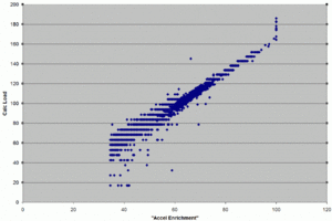

Graph: XY Scatter
"Accel Enrichment" vs Load calculated via MalibuJack's little app
...just trying to figure out what the Accel Enrichment is....

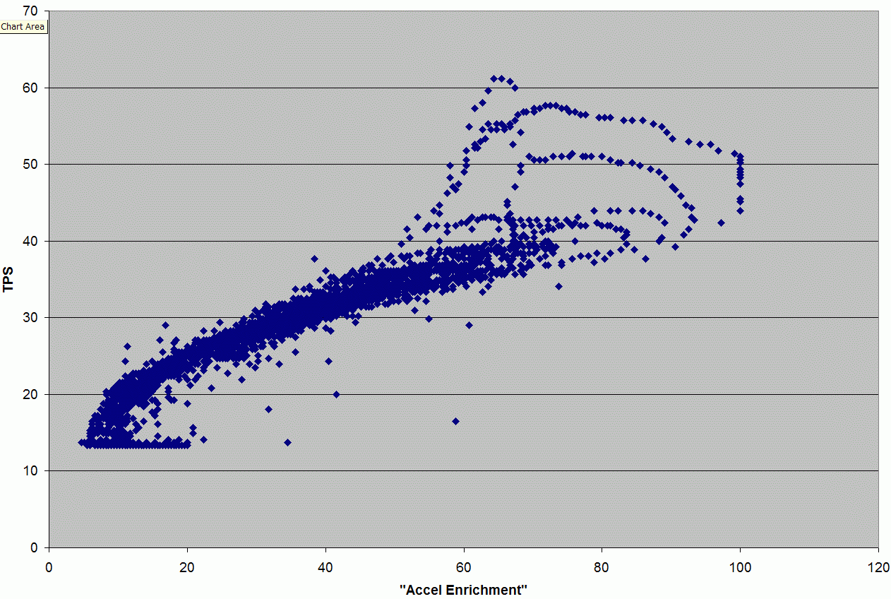

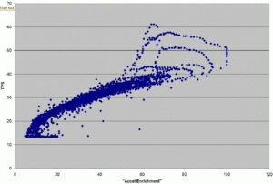

"Accel Enrichment" vs TPS

Looking at your charts, it seems to vary a bit depending on TPS, and 50% tps is likely 2v or so.. if it was actual TPS voltage in the ECU's Map, it would hit 100% just before you jump out of open loop.. so I guess thats not correct..
The ECUFlash program calls the scaling EnrichmentAdj so its definitely not what I had assumed earlier.. Perhaps its a modifier for injector duty?
