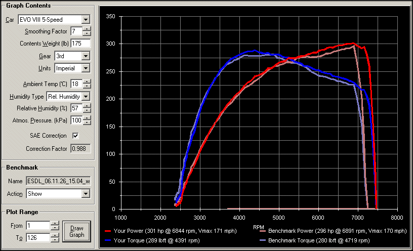

What Eric is saying is correct. I argued with him about this before, but now that I know more, I belive him. Today I did three logs in the pm hours. One log had a KS of 6 @ 3700 rpm and the KS continued to decrement as the rpms increased. So it went from 6-5-4-3-2-1. This continued all the way to redline. Using DataLogLab I ploted the hp/tq curve of this log vs the other log that did not have more than 2-1 KS here and there. As you can see the car lost power in the benchmark (knock prone run) as opposed to the "your power" run.
Attached Thumbnails Some advice with knock and adjustment [pics]-power_knock.gif
