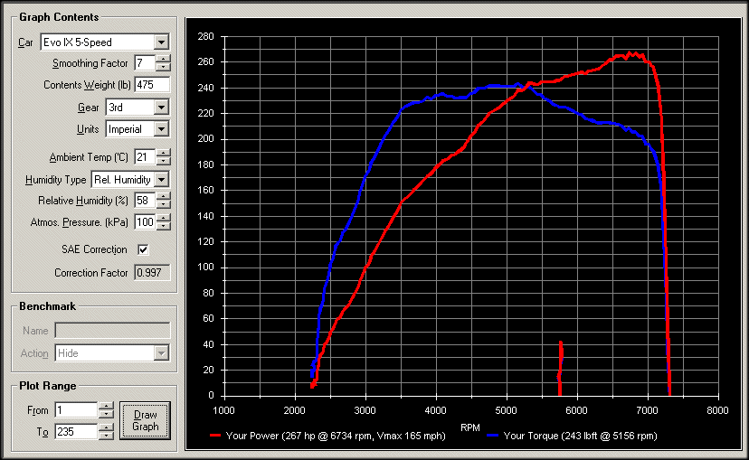

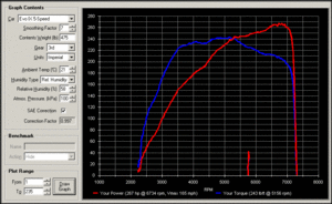

Another tip is to make your log that DLL reads longer than the WOT that you just posted. Include some data before and some data after the WOT run in the power graph. It should look something like this.
This is from a stock Evo 9 with a test pipe only. This is very close to the number that a stock Evo 9 puts on a dynojet. If you use the DLL correctly with all the proper data inputs and you test on a flat surface, then it can be surprisingly accurate.

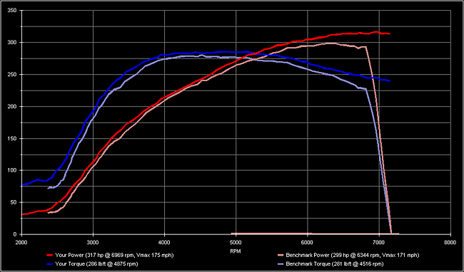

RazorLab's Avatar
Posts: 14,094
Likes: 1,093
From: Mid-Hudson, NY
l2r99gst,
I had the same findings, in fact, you can test it out right in the powercurve window with the "plot range" feature, move the "to" numbers back and forth and keep clicking the draw graph button everytime and you can actually see the peak curves change. I can make a car that was making 280 whp peak magically be making 300whp by just moving the "To" numbers back.
I have found you really need to keep the data of getting off the power, putting in the clutch or hitting the brakes so you can plot that downward curve. If you don't the software will make the HP line keep going up where it really wasn't.
Here is an example:
Old Dec 1, 2006 | 12:04 PM
l2r99gst's Avatar
Posts: 3,499
From: CA
Right, that's what I'm talking about.
I'm not sure about it's accuracy, but I would rather do it without the extra data....not because of the higher numbers, but because it shows the curves going all the way to the correct RPM.
For example, in your log below, what was the highest RPM that your took 100% throttle to? If you use the extra data, it brings the curve down prematurely because of using the same RPM or speed value twice.
Do you see what I am saying?
Eric
Old Dec 1, 2006 | 12:13 PM
RazorLab's Avatar
Posts: 14,094
Likes: 1,093
Eric,
yea totally I am agreeing with you. I believe the "your power" plot above was actually taken to the same as the benchmark. By me moving the plot range numbers back I cut off that cut off of 100% throttle and the plot magically kept going on in RPM and power.
DLL is a powerful tuning tool but you need to use it correctly to get accurate results.
Old Dec 1, 2006 | 12:27 PM
l2r99gst's Avatar
Posts: 3,499
From: CA
See, I am saying the opposite.
Without the extra data, the curves go up to the correct RPM. With the extra data, the curves will fall, to finish at the correct RPM at or near 0.
Like if you went to 7500 at 100% throttle and plotted the curves with extra past the 100% throttle point, the curves would go down to o at 7500, because it is using all of those RPM or speed points the second time (when you are decelerating) to fit the curves.
Eric
