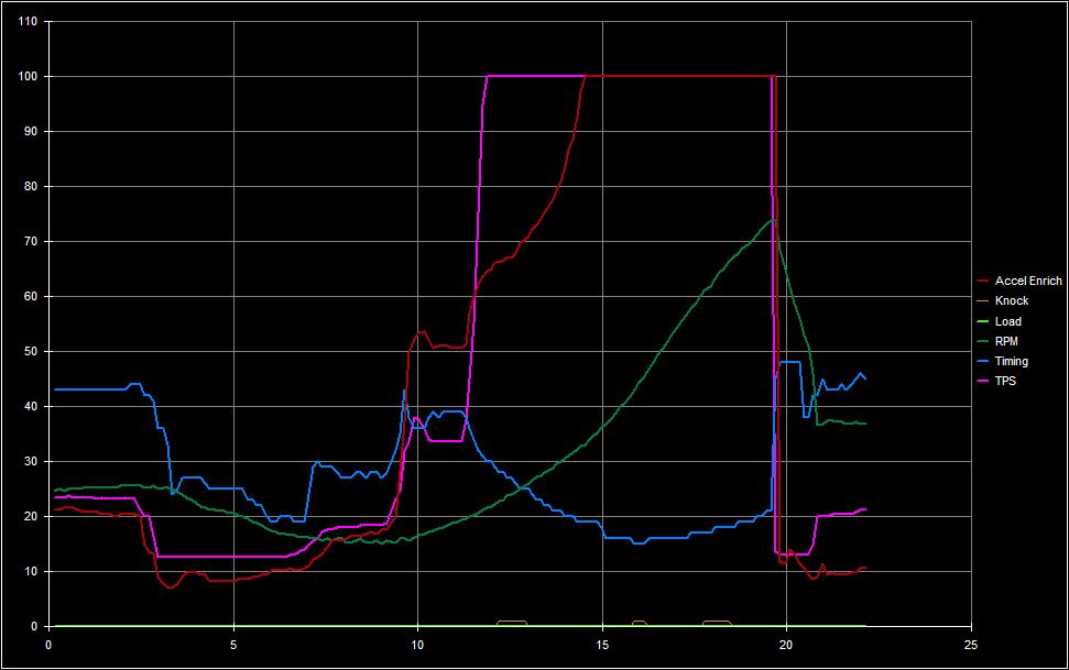

Why does that log show more than 15* at 4000 rpm?

Trust me, it ain't...at 4-5.5k, I'm only running 5-6*. It also shows that I'm running 42* at 2300 RPM...we also know that isn't right, right? Perhaps we've noted a deficiency in DLL.
Your timing scaling might be off then. My copy of DLL visualizes all my data correctly.
My DLL shows the exact timing as that of the log. I have had zero problems with DLL. I do not know why yours is off.
