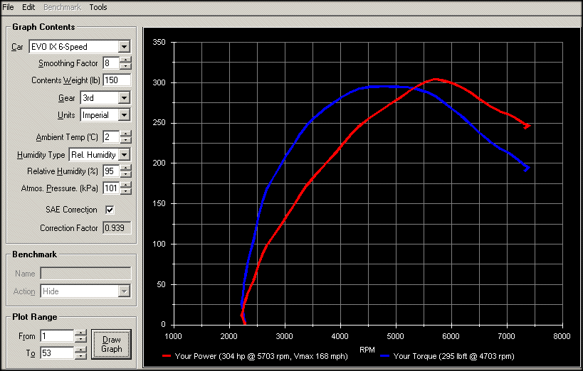

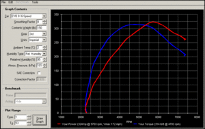

I have attached my DLL dyno graphs for your perspective (corrected and uncorrected)...Thanks Naji!
I think my WGA is lazy (opening too soon) and or my BOV as the boost comes on a bit slower than other IXs (has happened since new, with MBC, and now with modified BCS).

what's going on after 6000 RPM? you power really falls off badly. Who's tune is that?

Mellon -- I have a UR cat. on the car and think that is killing the top end. I am able to hold boost nicely (19.5 psi at 7K), but timing is at least 3* lower than before due to the cat. and knock. Jestr tuned the car with a solid 11.5 AFR from 3300 - 7250. My guess is that the Cat. + timing is robbing the top end of ~10 - 15 hp and a lot of area under the curve...Just my guess as boost is really solid. Thanks

Just so you know, any of these HP/TQ calculators use a slope function that is affected by several subsequent samples.. so if you cut the run short, or include too many or too few samples after your run is over, you will get it to trend up or down slightly which will affect your HP numbers.
In his case, I think he mentioned he might have a lazy wastegate actuator. I had trouble with mine because the pre-load was too light, the tradeoff of increasing the preload is you can get boost spiking. Other possibilities are a weak DV opening slightly (I saw this on a dyno tune I had done recently)

i still think these are respectable numbers for a mustang dyno (the original 315/315)...
your cat is probably hurting you a little up top... but i think MJ is correct with his post above.
I can understand a cat choking it some but seems like the power would flatline not dive.
No knock there?
good point, I've seen this too but it's always at the very very end of the dyno plot, not at 5500. I think what he's showing is a real problem, not a logger/plot issue.
he has an 06 car so I figured his DV would be solid... I'm running the stock evo 8 DV for what it's worth, but I'm not spiking to 26psi.. only 23-24 at the most.
