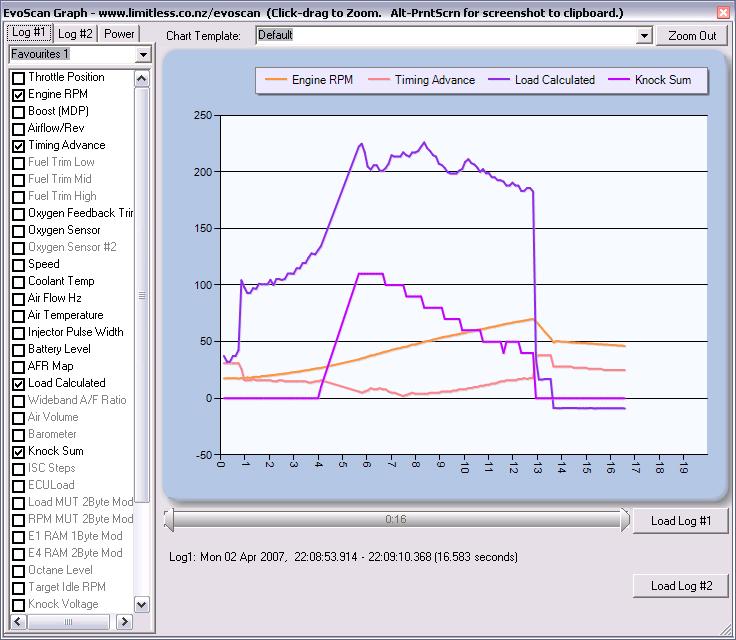

This is my first time really trying to tune my newly acquired Evo. I tried to lean it out up top and make the timing a little more aggressive; however, for some strange reason I'm getting knock down low that tapers off up-top. Any suggestions?
Knock starts at 10 counts and tapers down.

Defintely too much timing advace at the peak boost!

Gotcha, I'll lower it and post a new log later.

Post the .csv log data
