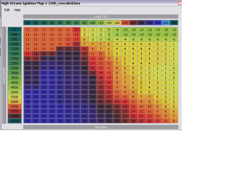

here is my timing for 93 octane. I'm running 23psi which lands me in the 245-250 load range, tapering to 22psi, which is in the 220 load range. Calculated load seems a bit low on my set-up....... i have verified my boost pressures using a MAP sensor as well as my GReddy Profec b SPEC II.
CJ

Good job on the conservative timing. I have my 93 octane map set up pretty much similar to yours, minus the 4* of block tuning that you have in one area of the map.
It seems to me that alot of people who log and tune their own cars are using this conservative approach to timing.
Here is my 93 octane map
