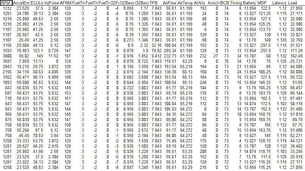

Why would you want to change Stoich, Your fuel Trims are off.
Show a log

Well here it is. I don't have COM port on this laptop so i had log without wideband but u'll see when rpm goes to 800 or less then my car is in OPEN LOOP AFR 10 and dying that is my problem. In open loop car works OK. My scaling number is 587, and fuel trims u see on this log they r weird because when i use OBD II Scan Tech my trims are way off it is something around 20-25.
