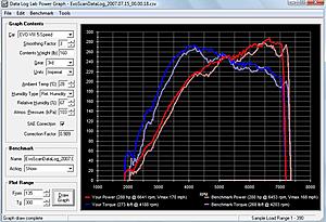

Hey Chris, I tried a test today that resembles these AFR numbers you mentioned here. Currently my spool up from 2500-3000 is 10.1 to 11.1 AFR, respectively. So I leaned the spoolup 12.7 to 12 AFR from 2500-3000rpm. The attachment shows my results. Its spoolup is significantly slower when it's leaner in my case. Is there something else I need to do?

that plot doesn't show spoolup, it shows torque and that can be impacted if you had some knock from leaning it out.
