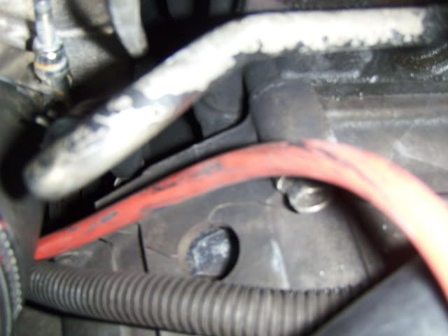

do not get the samco i had nothing but problems with the silcone,it ripes around the blowoff valve when u try to tighten it,get the hks hard piping much better off in the long run...i even had idling problems with it,
once i changed it everything felt better from idle to wot
this was perrin but u get the idea this was 6 months later

ive run the samco hose on my car & my G/F's IX for over a year with no problems, holding up fine, i cant say anything about perrin as they usually make good stuff but i wouldnt group all flexible intake tubes as bad just cause the perrin one failed. perrin makes many products, samco makes hoses.
perhaps they did not use enough plies of reinforcment or thick enough silicone
also, youll have a hard time finding any metal intake pipe with as smooth of a transition as the silicone, which is pretty important considering the diffrence in size of MAF & turbo inlet

maybe but my hks fit better then the silcone,this silcone would hit my lower raditor hose,my friend has the samco on his to and he had problems with the clamps riping it,but whatever he wants to do just posting up my exprience with silcone hard piping is always better....

I've run Samco on many cars and never had problems...overtightening will cause problems

Regular perforated worm drive clamps are BAD with silicone couplers. There are "lined" clamps and clamps that use an external threaded tightener so that the silicone coupler does not extrude through an improperly tightened clamp.
Get the right clamps...you will probably have a better experience.
