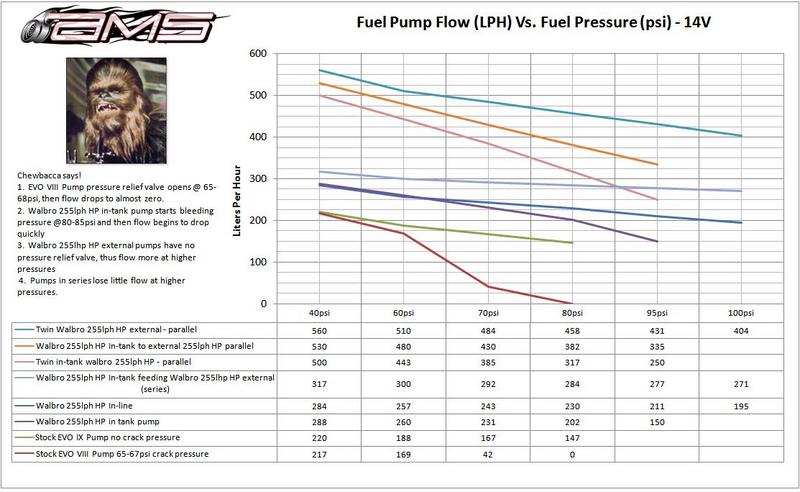

The Walbro isn't necessary for a stock turbo. An Evo IX pump would do fine. The VIII pump sucks because of the pressure relief valve.
If you haven't seen it before, here is the graph from the AMS test:

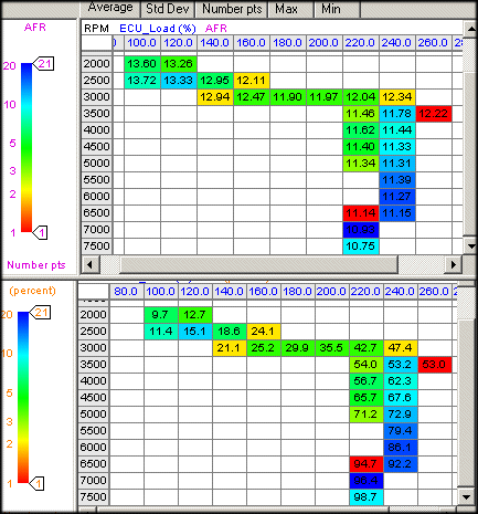

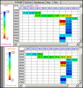

I agree with Eric and AMS and KevinD that a Walbro is totally unnecessary for an Evo 9 with basic bolt-ons. My 9 has a TBE with test pipe and LICP. I had a Walbro that I bought a while ago sitting in my room collecting dust. It was intended as a spare in case the Walbro on my Evo 8 gave out.
On Sunday my friends and I installed it on my Evo 9. Then I logged that car today at the same time and same palce that I did before the Walbro. The pump did not make much of a difference on the 9. I was hoping that my IDCs will drop significantly, but not a lot happened. The AFR did not change much. Only a slight change between 7000-7500 rpm.
Here are the charts:
before walbro:
AFR and IDC after Walbro:
I am begining to think that the way we calculate IDC for the EVO is erroneous. A lot of us are running around with close to 100% IDC and we are still able to lean out and richen the AFR at will. I believe that John Bradely's and Tephra are correct and we need to use the scaling of the injectors to determine IDC rather than use injector size.

good illustration nj... that goes along with the minor correction I'm doing for EVO9's with fp upgrades.
