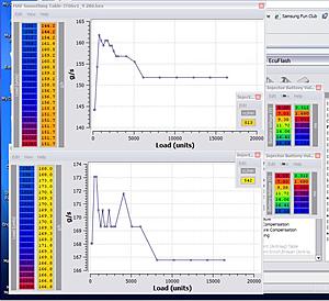

has anyone tried the 542 injector scaling with the corresponding injector latency and MAF smoothing tables?

Old Oct 30, 2007 | 10:26 AM
  #39
nj1266's Avatar
Posts: 3,254
Likes: 13
From: USA
Originally Posted by tephra
now redo it with 2byte RPM lol you will be hitting 105% IDC
