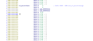

ok simply:
1) open your ROM's EcuFlash XML (ie 94170008.xml)
2) find the xml for the high octane fuel map
3) copy the address (0x33bd in this case)
4) in IdaPro press keyboard G and paste this address in.
5) now backtrack a few bytes until you find the "reference" that Ida has to the current section of ROM
see the image

Ok, so I have figured out how to disassemble, but now I guess you guys LABEL everything so you know what code you are looking at? I noticed in the attachment you had a few posts back, you had the reference line state that its for the high octane code? here is what I see (from your NLTS hex file). Should I be changing this reference code?
I must be getting on your nerves by now,lol.
Old Nov 27, 2007 | 05:42 PM
tephra's Avatar
Joined: Feb 2007
Posts: 9,486
Likes: 67
From: Melbourne, Australia
well you can label unk_33B2 to whatever it is (hioctfuel??)
you can can press D twice on each of those start "h'FF" to convert them into a memory variable.
but yes labeling known things is a big first step
what ROMid you got and pm me your email address I will send you my current disasm for your ROM..
