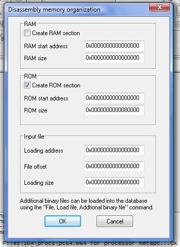

help needed!
on the picture where should i but the 0xFFFF and where goes 0xFFFF0000
I have been testing everything but nothing works for me only when i leave as it is then i get something but the values are not right.
thanx

set your RAM start address to 0xFFFF0000 and RAM size to 0xFFFF
