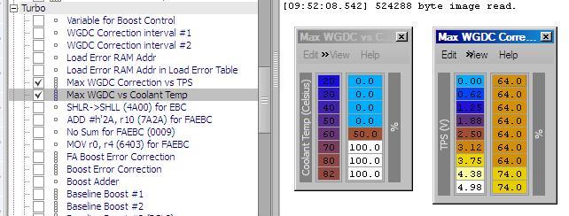

Hey Guys,
razorlab PMed me about this last night. It looks to me like the definition in ECUFlash is completely wrong. In the ROM code, this value appears to be a threshold test on the WGDC read from the BWGDC tables. The stock value is 62.5% WGDC. If the WGDC read from the BWGDC table is below this threshold value, then the ECU chooses between the value from the table or some other value that it calculates in another subroutine. It doesn't appear to have anything to do with temperature.
There is however a table that does control WGDC vs temperature. I found it a while ago but never published it. There is also another table that controls the maximum WGDC "correction" vs TPS. Screenshots will be attached shortly.

Originally Posted by mrfred
Cool. Thanks, MrFred.
So based on your table you have if my temp is 70 degrees or more then the ECU will use 100% of the value that's in the BWGDC table? That explains why I was running my target WGDC.
