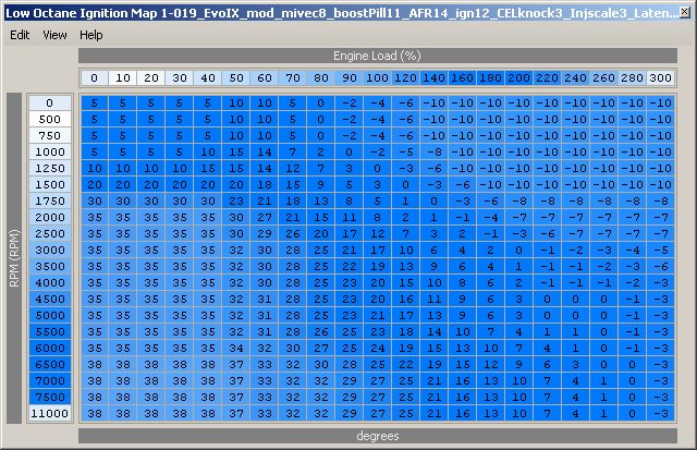

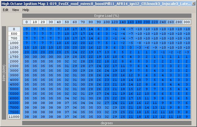

The updated maps used in the previous log are the following:
High octane (#1, #2, #3 are the same):
Low octane (#1, #2, #3 are the same):
Note: the low octane map is no longer like stock, is little advanced to try as TouringBubble said.
It is very conservative because on street I'm not 100% sure to find a Shell pump everywere...
Attached Thumbnails Time pulled without apparent reason...-timing2.jpg   Time pulled without apparent reason...-timing3.jpg
