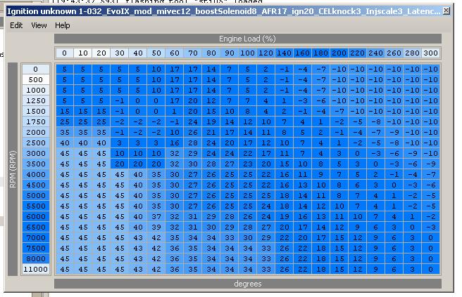

Some news: I have found an additional ignition map that looks a little strange - like a protection map.
I'm pretty sure that my negative timings comes from here. In 88840016 has address 0x65B5.

Mmm... looking in asm code it seems to be a sort of "High Octane Ignition Map 4" used in some way from the ignition main subroutine, but I have to find when...

Do you know when map #4 is used?
