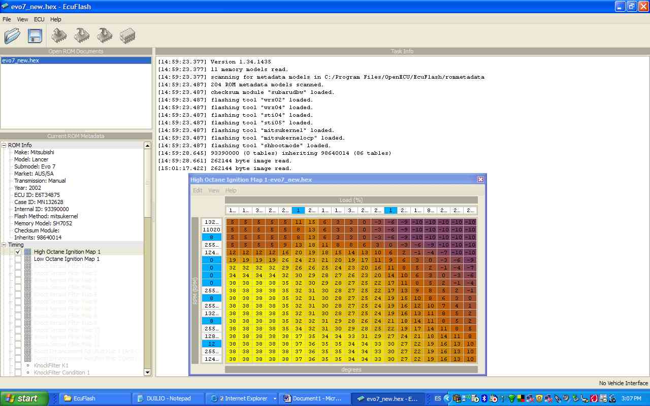

Thanks fbikawi,
I might be doing something wrong since its not working good.
I have some weird values.
Regards

OK I found the problem,
On EcuFlash v. 1.34 I cant read good the values but on V.1.30 they show good.
Thanks for your help.
